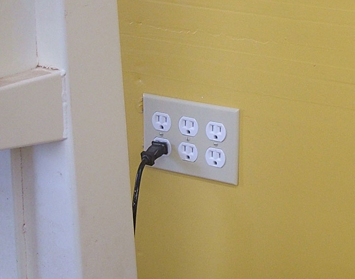

* First I had the current outlets in the shop expanded to look like this (this was based on a suggestion Bruce had made to me):

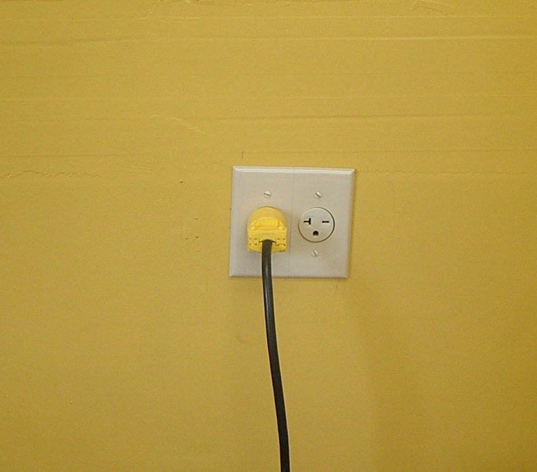

There are four of those around the shop, then I had the electrician wire in 220 for the tools, we ended up with jacks like this:
Those are 220V single jacks that have a horizontal slot so there is NO way you can plug a 110 device into them, they have their own breaker. I can't imagine not running my tools on anything but 220 now, while I'm not building guitars I have been working on other things and the difference is night and day...

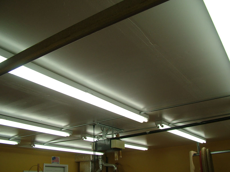

Next we installed lighting, after lots of research I ended up with this setup:
There are 8 pairs of 75W 8 Foot lights in the shop, the first time I turned it on it was like walking into the outdoors, at first we thought it was TOO bright but now that I've had the chance to do some work in it I'm not changing a thing. There are no shadows, I can see everything and only need my little lamps for intricate detail work, everything else these lights cover, it was a good investment.

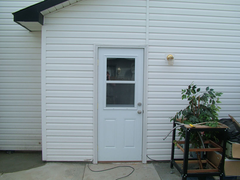

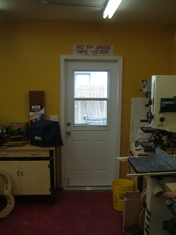

I changed the old door to one that opens outward, added a window so I could let fresh air in and Voila!!. The door no longer opens into my tools, You have to add special hinges so creeps can't take the door off but it was pretty easy to do.

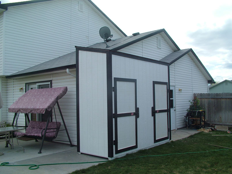

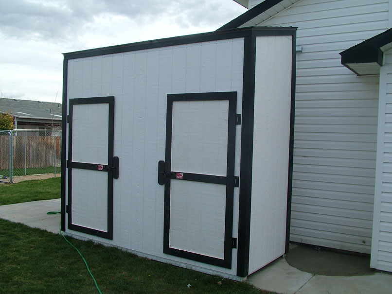

Now for the fun stuff, we had a shed built to house the Dust Collector, air compressor, wood and solvents (paints etc). The *plan* was to fit it into a little alcove next the garage, the end result was that we mis-communicated and I ended up with a monster:
To be fair it's a very nice shed, but I'm going to have to add a gable to that roof to make it fit. I've already got 220 and 110 outlet boxes ready for it, so it's just a matter of doing some custom roofing. We are going to finish the inside where the wood will be and seal it up to like a hotbox for wood storage, the other side will house the mechanicals.

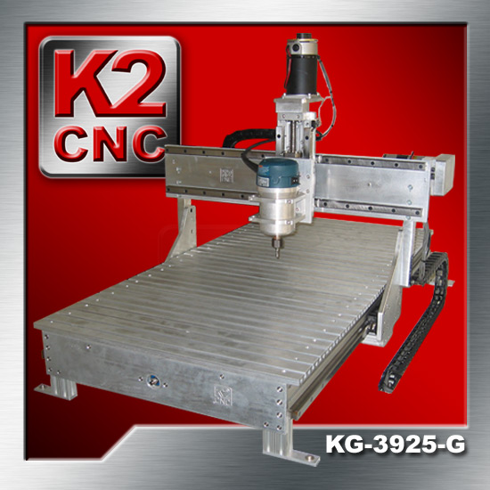

I have also at the same time all this is happening have taken the full plunge into the world of CNC, I spent time researching and doing lot's of reading. I ended up buying this machine: K-2 CNC Machine
I was faced with two options for CNC, go the DIY route or pay the $$$ for one already built. These guys had good comparable prices and have been very easy to work with, this is the single biggest purchase for the shop I have ever made, after a lot of thinking I decided I would rather buy something from a company that has worked out the kinks instead of going DIY and having to build 2 or 3 revisions to get it right.
They spent a good deal of time on the phone with me going over what I wanted to do and had some really good suggestions about how to do things like make parts much more effeciently. I just dropped half down and should have the machine in a couple of weeks, then I have to learn Rhino Cad/Cam (doing that now) and convert my current Turbo-Cad drawings. I plan on making parts, jigs, inlays, rosettes, briges and possibly neck blanks with the machine. My goal is for things like making a mortise and tenon to remove me as much as possible from the picture so I can get consistent results. I can do that now but it requires so much time, with this I can set it up and go work on something else....
I will be posting pictures and information about the setup once I get the machine up and running, that's still a bit away's. I haven't even built a computer for it yet

I don't know if it is the same over in the US(not sure how many hertz your electricity runs at), but when using large amounts of strip lights like you have there there can be a strobe effect, that makes spinning saw blades etc look stationary when they are in fact in full flight, the way to overcome this is to tape the first two inches of the tube at either end. The shop looks wonderful.

Russel the only thing I have noticed so far is some humming, nothing too much but I have seen no strobing as of yet, those fixtures where not cheap and I'll be pretty mad if they start acting up like that.

And there aint no cheatin in using a CNC, it's just a tool, I still have to fit and tweak the final results

It only occures when the revolutions that the a blade is say spinning, somehow (I'm a great scientist) come into sync with the Cycles in the current, I've seen it twice once on a large cross cut saw, and on a small chop saw I have. The blade looked like it was motionless when in fact it was spinning, ok you can hear it, but with ear defenders on or in a two man shop a potential hazard. If you haven't seen it with your kit chances are it won't happen.
